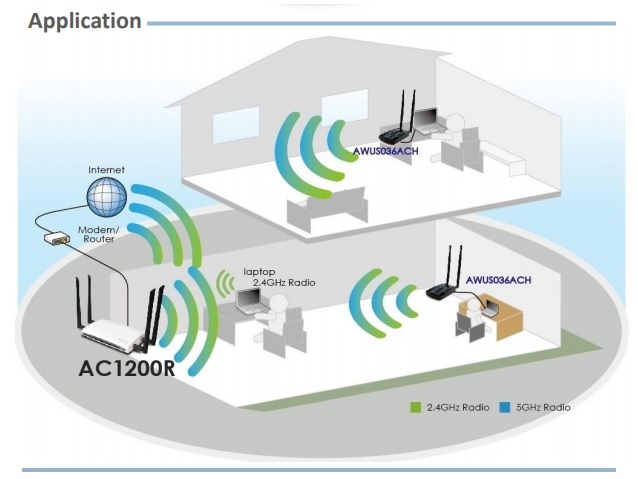

The ZTE MF288 has no external Wi-Fi antennas, only internal PIFA antennas. Consider using Wi-Fi extenders/adapters to extend the Wi-Fi reception from this router, like this option.
Note this may not give an ideal signal improvement if there are thick walls or other major hindrances to RF signals.
Wi-Fi adapter Application
