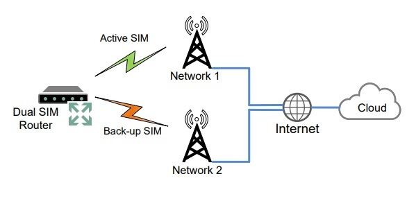

Dual SIM routers have a single cellular modem with double slots to insert two SIMs. With these routers, you can connect two different carriers but have one active carrier at a time. When the active carrier goes down, the second carrier can be activated.
Dual SIM structure
In North American cellular market, a modem must have a specific carrier firmware image (modem firmware) loaded to work reliably (ex: VZW, ATT, Generic (T-Mobile, Canada), Sprint) on the respective carrier network.

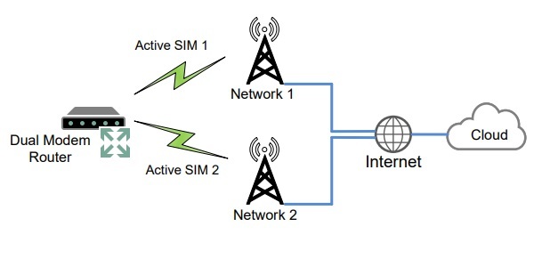

For dual modem, the cellular gateway will have two physical cellular modems available internally (they can be embedded, modular, or a combination of both), or with an option to extend an external modem e.g. cradlepoint dual modem capable routers.
Dual modem structure
Dual-modem functionality is an excellent way to attain seamless, instant carrier redundancy in your network. See more on link aggregation.

Because the gateway is a dual SIM (single modem) and not dual modems, it cannot provide two simultaneous connections or be load-balanced. Dual Modem: if you want to utilize multiple SIMs simultaneously for a faster connection/higher bandwidth (ex: Load Balancing or Bonding).
