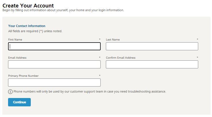

1. Login to your account (If you don't have one you could Go to MyNexia.com and click "Sign Up" to create a new account).
