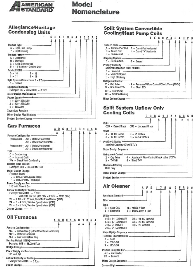

Yes, Trane XL824 is. The Trane thermostat with this model number (TCONT824AS52DAA) is also marketed as ACONT824AS42DAA by American Standard and is succeeded by ACONT824AS42DBA (TCONT824AS52DBA).
You can use the below as model nomenclature reference.
Model Naming
