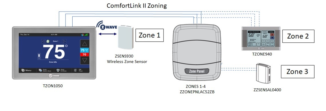

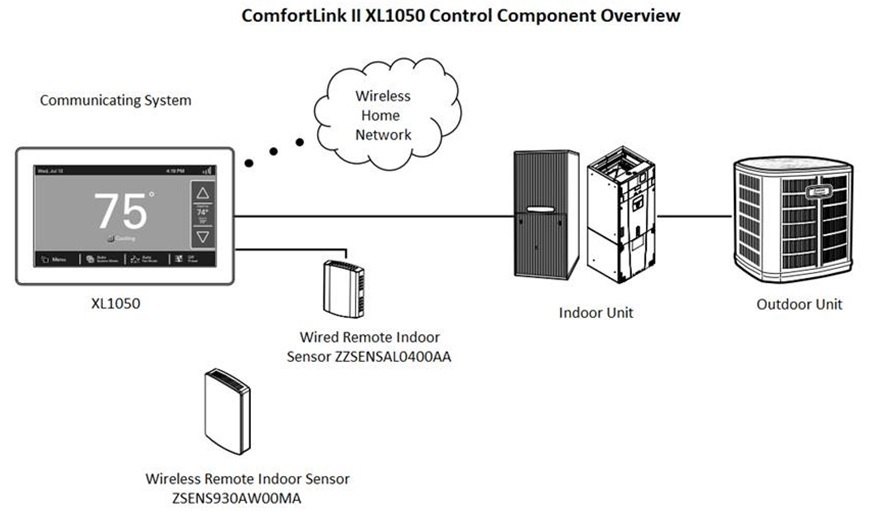

I have the Trane XL1050 and i wanted some sort of sensor that i can put outside my kid's room before the summer heat rolls in. I'm hoping that there is a way to have the XL1050 respond to the temperature at the remote thermostat instead of the temperature where it is mounted (it is currently mounted down the hallway which makes my son's room very hot in the summer). Also wondering if there is also an option to have a second thermostat in a different corridor and have the thermostat average the temperatures. Finally would be nice if there was a wireless sensor so we don't need to do any wiring although that's not an absolute requirement.

The Trane ConfortLink II XL1050 works with sensors to monitor and optimize humidity and temperature at the desired locations in your home. The sensors used by the XL1050 thermostat include; ZZSENSAL400 Remote Indoor Temperature Sensor, ZSENS930 temperature and Humidity Sensor and TZONE940 Wired Touchscreen Thermostat/Zone Sensor.
Different areas or zones in your home are monitored by a sensor in constant communication with the ComfortLink II thermostat.
Zone diagram
The ZZSENSAL400 Remote Indoor Temperature Sensor monitors temperature within a specific zone, while only allowing temperature adjustments at the Communicating system control. This is ideal for a kid's room.
TZONE940 acts both as a sensor and a thermostat which lets you monitor and adjust the temperature in one specific zone. This can further share data with the XL1050 thermostat (master zone control) ensuring consistent, even comfort in each zone.
In place of the XL1050 on-board sensor, the ZSENS930 (ZSENS930AW00MA) wireless temperature and humidity sensor can be used to remotely sense temperature and humidity. This may as well be used to sense and display temperature and humidity on the Nexia smart home portal and mobile app. A zone panel such as the ZZONEPNLAC52ZB is used to monitor up to 4 zones whereas the ZZONEEXPAC52ZB Zone Expander expands the maximum number of zones per system to eight.
Zone panel
