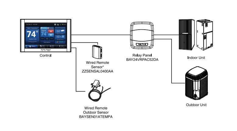

I need help finding the right equipment for my Trane zone system. I have a Trane XL1050 thermostat (https://shop.rfwel.com/trane-tzon105...fi-thermostat/) and its relay panel but I need to know what else I need.

At the heart of your zoning system is the Trane ComfortLink II Control (XL1050, XL850, XL950) coupled with optional zone sensors. For conventional 24V HVAC systems (5 heat/2 cool/dual fuel) a 24V relay panel accessory is required.
The optional zone sensors and thermostats include the following:
1. ZZSENSAL400 Remote Indoor Temperature Sensor
2. ZSENS930 Temperature and Humidity Sensor
3. TZONE940 Wired Touchscreen Thermostat/Zone Sensor
Component Overview
Trane Comfortlink
