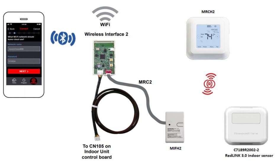

There are both wired and wireless options that you can consider for your application.
The MHK2 is a wireless controller kit that will give you the ability to set a daily schedule. With the MHK2, you can also use the Kumo Cloud app to control your unit and set a daily schedule but would need a PAC-USWHS002-WF-2 Wireless Interface to work with the unit.
PAC-USWHS002-WF-2 is the Interface Adapter for the Kumo Cloud application that has a port to connect an MHK2, but can also stand alone and be the controller for the unit. This way it can offer programming and operation of your system through a local network or remotely through the application.
Wired controllers that can work for your indoor unit are PAR-41MAAU and PAR-CT01MAU-SB. These remote controllers need a MAC-334IF-E Interface to control them to offer control. They only offer weekly but not daily schedules.
