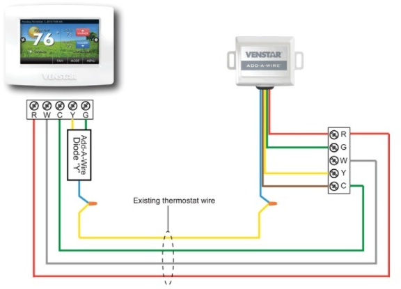

Addition of C Wire
A Common wire is an extra wire that creates a continuous 24V power loop between the thermostat and the entire HVAC system. This way, the full potential of thermostats and their applications can be achieved. Basically, this provides the return path that completes the loop avoiding power disruptions.
To identify a C wire, simply detach the thermostat from the wall and look at the wires connecting to it. If there is a wire connected to the terminal labelled C, that is the common wire.
If your system does not have provision for a C-wire, there are several methods that can be used to add one. They include:
1. Use of C wire adapter kit
Some manufacturers including Venstar have an accessory such as Add-a-Wire Adapter that can help in solving C wire problems.
2. Using C wire in place of the existing G wire
3. Addition of C wire to the furnace
Running a new cable from the furnace to the thermostat to install this in a majority of the modern smart thermostat models.

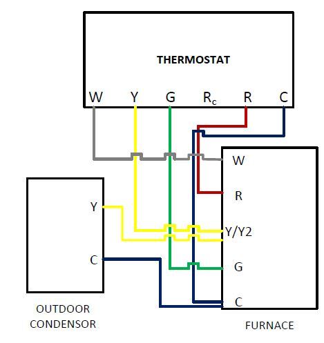

Sample Wiring Diagram
Here are different thermostats that can be wired to your HVAC system.
