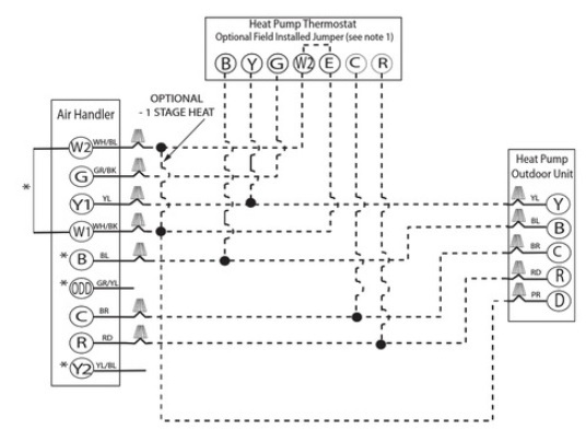

Yes, the Honeywell RTH9580WF Wi-Fi Smart Thermostat can work for your unit.
The RP series of heat pumps are designed to operate with standard 24 VAC thermostats and air handlers or gas furnaces. Determining wiring designations and feature compatibility of the wireless thermostat is essential. Turn OFF the power supply from the main circuit breaker before proceeding.
Below is the control's wiring diagram;
Ruud RP1430AJ1NA Wiring
The wiring should be done by a certified HVAC technician to avoid any injury or damage.
