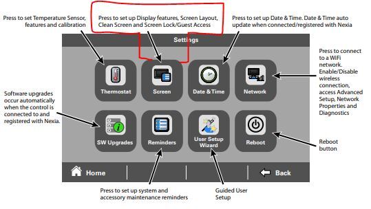

Trane's XL1050 ComfortLink II Control screen not responding to button press suggests that it is either out of calibration, there is an internal fault in the thermostat, or screen lock has been enabled.
To fix this, please try doing the following:
1. Remove the Trane XL1050 Control from the sub-base and reset.
To access the Installation Wizard to RESTORE FACTORY DEFAULTS, Please go to
Home > Menu > Service > Technician Access > Proceed > Installation Wizard
The Setup Wizard will guide you through the following screens:
  • Display
  • Screen Layout
  • Scheduling
  • (A) Guided Schedules OR (B) 1-Touch Presets
  • Network
  • Nexia
  • Weather
(You may skip any section of the Wizard by pressing Cancel)
2. Press and hold the Menu button for 5 seconds to override screen lock.
Alternatively, check screen lock settings from the screen section as shown below:
XL1050 Screen
For other custom HVAC control solutions, feel free to contact our HVAC experts for assistance.
