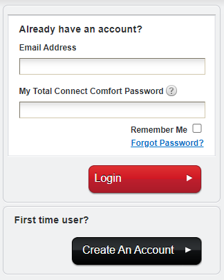

  5. Set up your account and register by visiting www.mytotalconnectcomfort.com and create an account.
ComfortLogin
  • Validate the account
  • Log in and register the gateway at www.mytotalconnectcomfort.com by entering the MAC ID and MAC CRC found on the bottom of the device

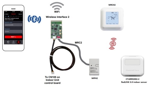

You need a PAC-USWHS002-WF-2 Wireless (Wi-Fi) Interface Control which you will connect to your indoor unit and MHK2. The connection overview is as shown below.
PAC-USWHS002-WF-2 Connection
Before doing this, one needs to confirm the compatibility of their unit with this interface. The compatibility list is on the interface's submittal. One PAC-USWHS002-WF-2 is used by one MHK2 thermostat so as to control your indoor unit from your phone through Kumo Cloud App.
This can also work for MHK1.

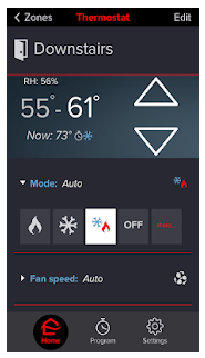

Download Kumo Cloud App from the Apple Store, Google Play Store, or Amazon and install.
Kumo Cloud
To the Kumo cloud App, you can add extra accessories such as PAC-USWHS003-TH-1 (Wireless Temperature & Humidity Sensor) and PAC-WHS01HC-E (Kumo Station Equipment Controller).
