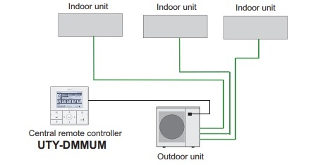

I have AOU36RLXFZH, ARU7RLF, ARU9RLF1 and AUU12RLF Fujitsu units. What I need is one wired remote controller so that I can be able to control all of them from one place. Is this possible?

Yes, it is possible to connect and control all your units using a central controller. This is the Fujitsu UTY-DMMUM Multi-Zone central remote controller. UTY-DMMUM can control up to 8 indoor units simultaneously. It is wired to your AOU36RLXFZH outdoor unit. The individual indoor units are then connected to the outdoor unit as well.
Component Overview
Click image for larger version  Name:	UTY-DMMUM Wiring.jpg Views:	110 Size:	15.7 KB ID:	2841
Wiring should be done by a certified HVAC technician to avoid any damage of property or injury.
