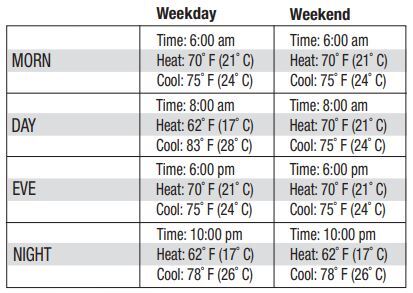

There might be no issues with your thermostat. Braeburn 5000 Thermostat is pre-programmed with weekday and weekend set point times and temperatures. These settings provide efficient energy savings during normal heating and cooling modes of operation.
B 5000 Set-Points
These are the same points that may have been assumed and used as personal program settings.
You may come up with new settings and programs after pressing the RESET button.
