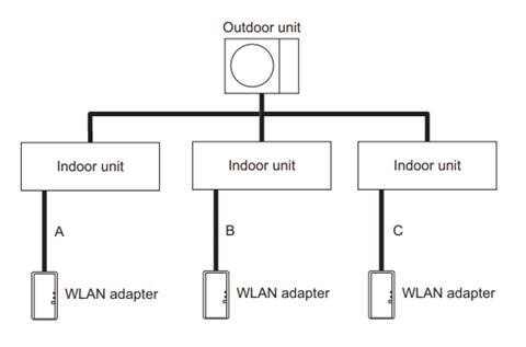

Below are solutions that you may consider with respect to central control of your indoor units:
1. Wireless LAN Adapter

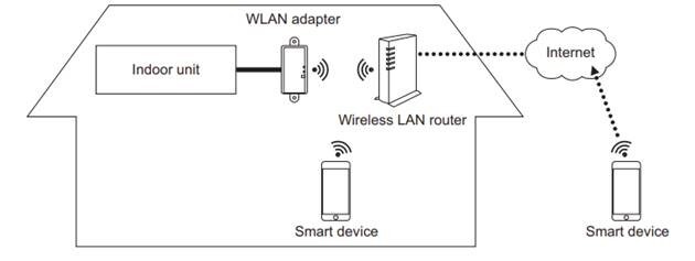

This option uses 3 WLAN adapters (UTY-TFNXZ2) for each indoor unit (each indoor unit requires its own interface module/ WLAN Adapter). The UTY-TFNXZ2 WLAN adapter / WIFI Interface Module provides remote cloud control and monitoring of your slim duct system through the internet using the free FGLair App (Smartphone). For initial setup, the smartphone has to be connected to the same wireless router that the WLAN adapter is connected.
See illustration in the schematic diagram below:
Schematic Diagram
Sample system diagram:
System Diagram

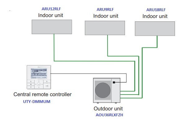

2. Wired Central Controller
This option uses the UTY-DMMUM Central remote controller (wired) that allows control of up to 8 indoor units on a Hybrid Flex Inverter (HFI) system (in your case AOU36RLXFZH) which can be done simultaneously. The Remote controller connects in daisy chain to branch boxes.
