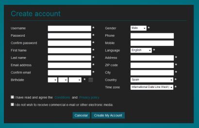

You have to download the App on your smartphone or tablet or visit the webpage as well. Download the IntensisHome App from the App Store, Google Play, or Amazon and install. Create your account

Then go ahead to feed in your personal information
