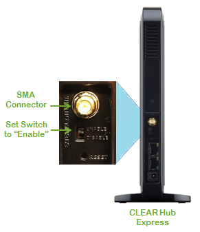

    The Clear Hub Express WiMax modem has an RP-SMA-female (Reverse Polarity SMA Jack) connector so you would just need to select the RP-SMA-Male (Plug) option in this kit: https://www.rfwel.com/shop/4G-USB-Mod...tenna-Kit.html. The most popular antenna in the kit is the 18dBi panel antenna and this works the best for most people.
    Of course be sure to place the internal/external switch to the right setting.
    Alternatively, to hook up this antenna port to N-Male cable use an RP-SMA-Male/N-Female adapter. To hook up to other cable types use the appropriate adapter here: https://www.rfwel.com/signal_improvem...n_adapters.php. To find other Wimax antenna types such as table-top low-profile antennas go here: Wimax antennas

    Since this modem has one antenna port, what sort of adapter would be necessary in order to attach 2 antennas?

      Sadly you cannot split this into two.

        ... yes but,
        nino riff has a utube vid that shows how easy it is to open up the HE, to locate the 3 antenna tabs on the logic board. Could connect 2 external antenna fairly easily if one wanted, no? Voids warranty, but they are selling these things cheap right now.
        According to nino, you can do a simple 'mod' buy placing the pigtail of the rp-sma connector port on the HE, onto the logic board 'ant 2' tab, which is claimed is a 'always' connected/enabled, vs the other tabs which are controlled by the external disable/enable switch you show in your post. That if you have the internal omni antenna and external antenna connected, that you'll see less strong signal; than if you only had an external antenna connected.
        my guess is your answer is that it depends.

          You are exactly right - thanks for clarifying my answer. If you are opening up the case and attaching external antennas directly to the antenna posts then yes you can attach two antennas. I think pooleds was asking about somehow "splitting" the single external antenna port (that is outside the case) to allow attachment of two antennas to it which you clearly cannot do.
